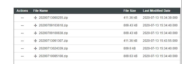

I have created zip files on SystemRepository as a backup. Is there any way to get last created file or Folder ?
I see there is Last modified date on Mashup but not sure how to utilize that to get last created file. Attached Screenshot of Files.
khayes1Answer
July 13, 2020
some of the file repository services (e.g. GetFileListing() ) return a shape which has a 'lastModifiedDate' property.
You could sort your info table based on this property and select the appropriate entry.
