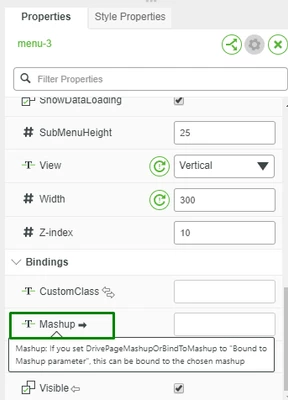

Hi, the menu widget has a Mashup property which we can bind to other widgets or a service. This property gives us the Mashup name selected from the Menu item. Please refer to the below screenshot.
Hope this helps.

Thank you for your concern but I'm not able to achieve what I want.
I bind this mashup(which you display in the screenshot) with my service parameter but I'm not getting anything.
I checked with the logger it is showing undefined.
I got one more way. Menu > Service > GetEffectiveMenu with All Data of this service I'm getting all menu data.
But I need only the selected row. Like the menu, the name is Menu1, Menu2 & Menu3 is written If clicked on Menu2 then I want every detail of Menu2 like mashup name, parentID, menuId, and other details.
But with this service, I'm not getting the details of selected rows.
