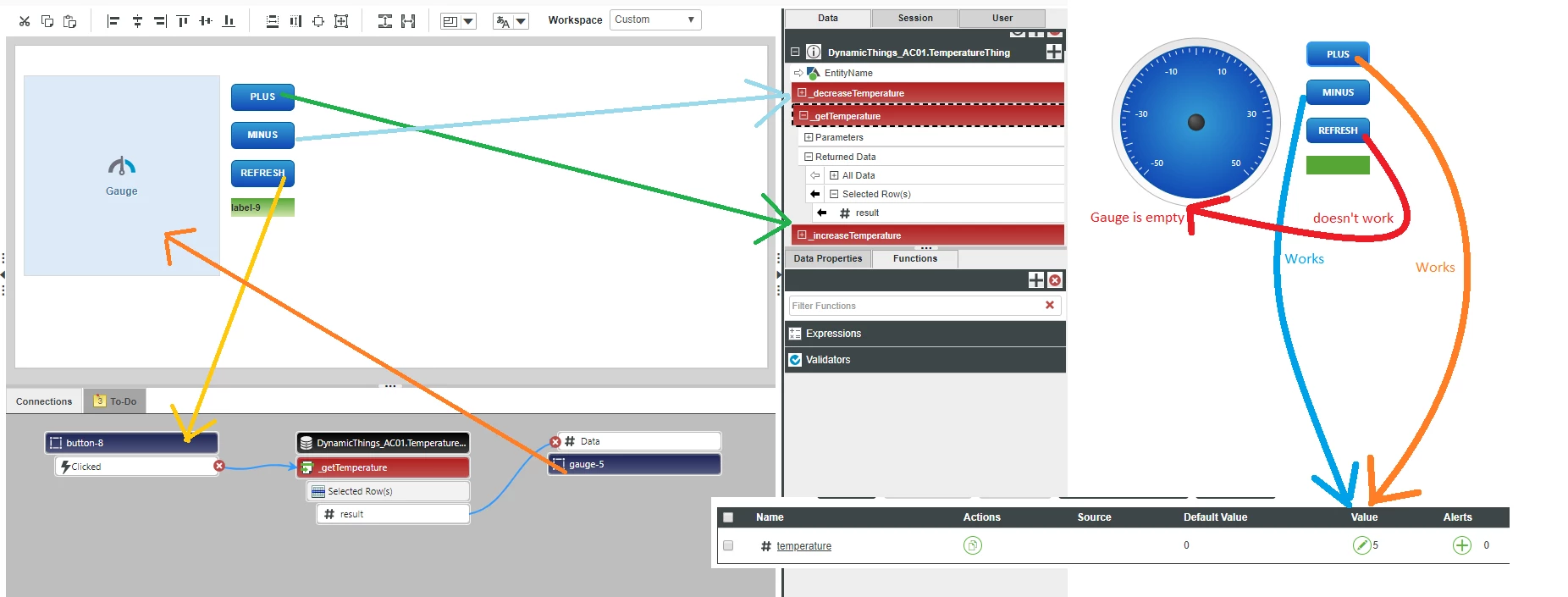

How to get numeric value from thing property and set it on gauge
What I've done:
- thing created
- in thing:
-- property created: temperature NUMBER
-- service created: getTemperature():
var result = me.temperature;
output NUMERIC
-- service created: increaseTemperature():
me.temperature++;
-- service created: decreaseTemperature():
me.temperature--;
- mashup created
- in mashup:
-- added gauge widget
-- added label
-- added button: "plus"
-- added button: "minus"
-- added entities: all 3 services from thing
-- connected button Plus click event with increaseTemperature()
-- connected button Minus click with decreaseTemperature()
-- connected gauge data with getTemperature()
-- connected label text with getTemperature()
Now I try to view my mashup
Buttons Plus and Minus work well. I see in the model that my value changes correctly.
But Gauge and Label don't work. Gauge doesn't show Arrow.
Label doesn't show value.
What I'm doing wrong?
I've make even a third button "refresh", and I've connected the click event with getTemperature(), and then the output I've connected to my gauge and label, but still it doesn't work.
mettAnswer
June 15, 2019
Fix:
- Make sure getTemperature() is not dynamic entity
- Use All Data instead of Selected Row
mett1-VisitorAuthorAnswer
June 15, 2019
Fix:
