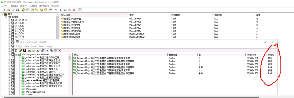

how to get the PLC connection state in the kepware?
how to get the state in the picture in thingworx service?

Hi @LY_10340318,
You can check the data quality from the small icon at the beginning of the Source column:
You can also fetch the string value of that quality by executing the service from your Remote Thing > Services > GetPropertyValuesVTQ

Hi @LY_10340318,
Dec 19, 2024 5:27 AM UTC
Hi @LY_10340318
You can also use GetPropertyQuality service to get Property binding quality.
