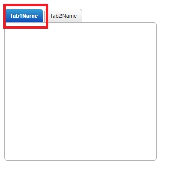

Tab names are not Bindable, so the only way would be to:
Create and Assign localization tokens
overwrite the tokens and reload the tokens.
I don't even know if this approach will work, because the token reload needs a screen refresh.
Perhaps the other route is easier, customize the tabs widget to create an extension with bindable tab names.
