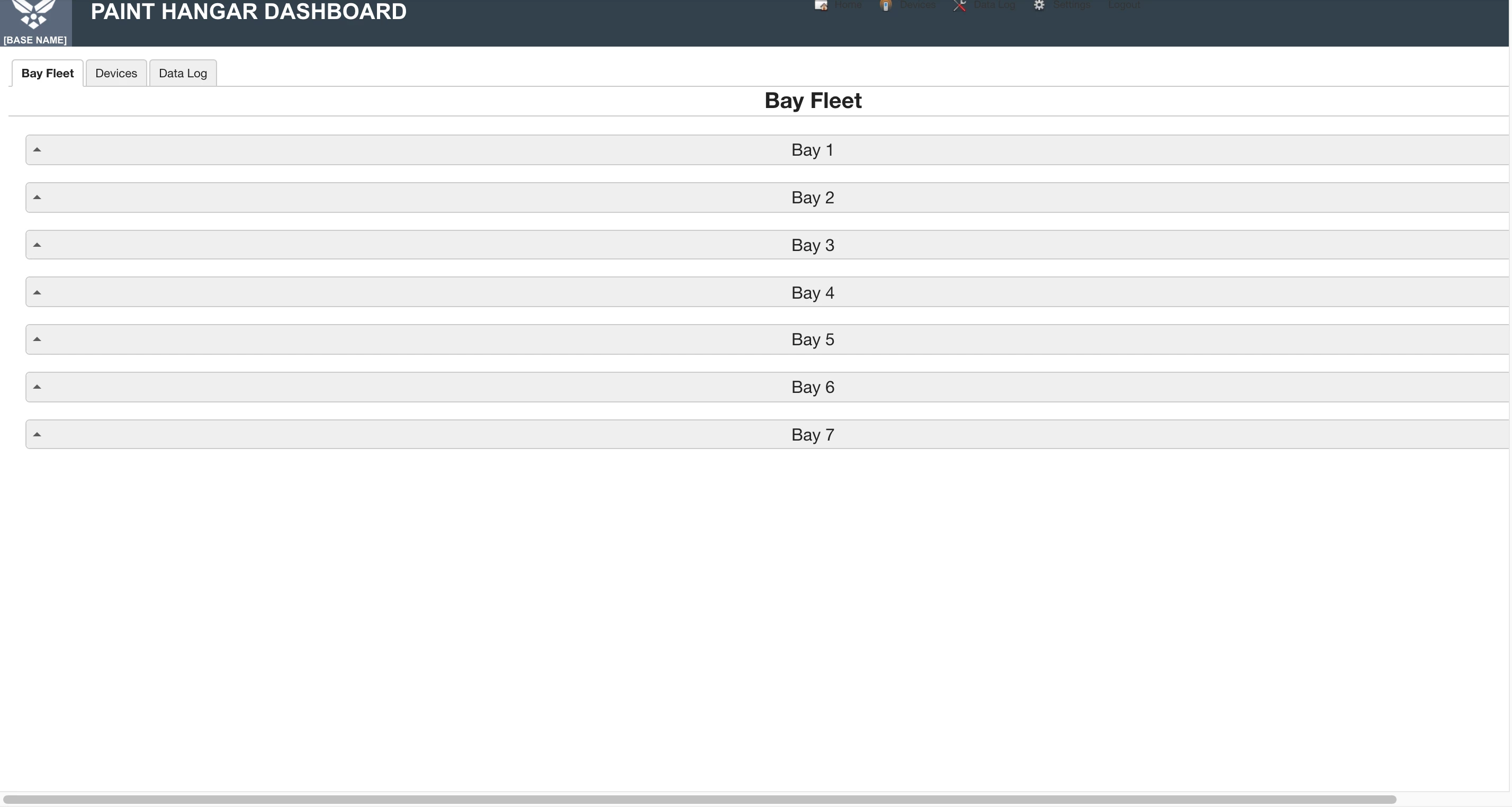

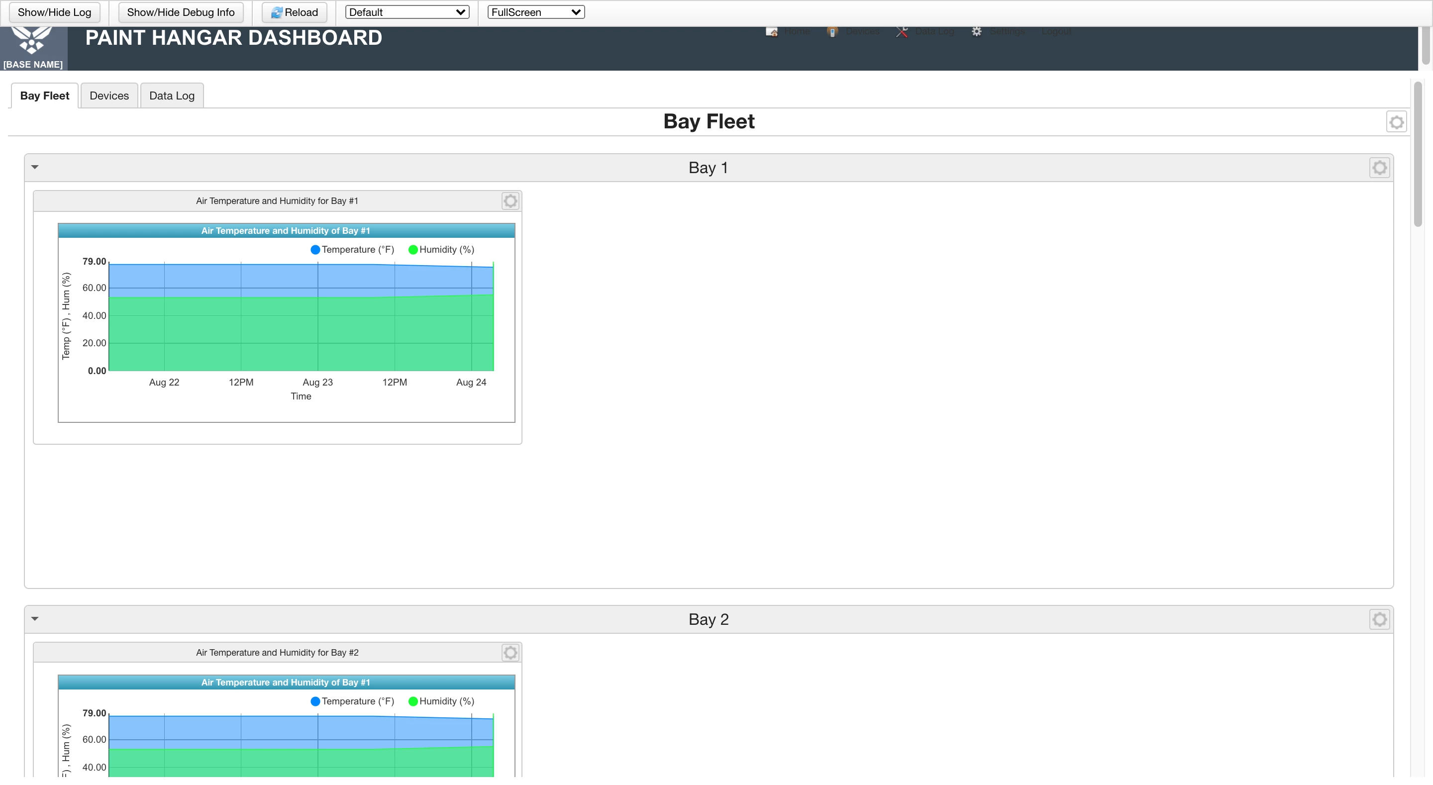

Currently the default for Dashboard Widget - is that the groups are expanded. I would like them to be collapsed in size for when I view the mashup.
In the attached files below you can see how the groups are defaulted to being expanded. In the second picture, I collapsed each individual group - that is what I would like it to be looking like.
Any direction would be great - thank you!

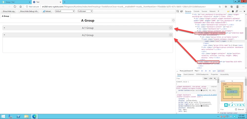

It seems that there are no attributes to control the default behavior.

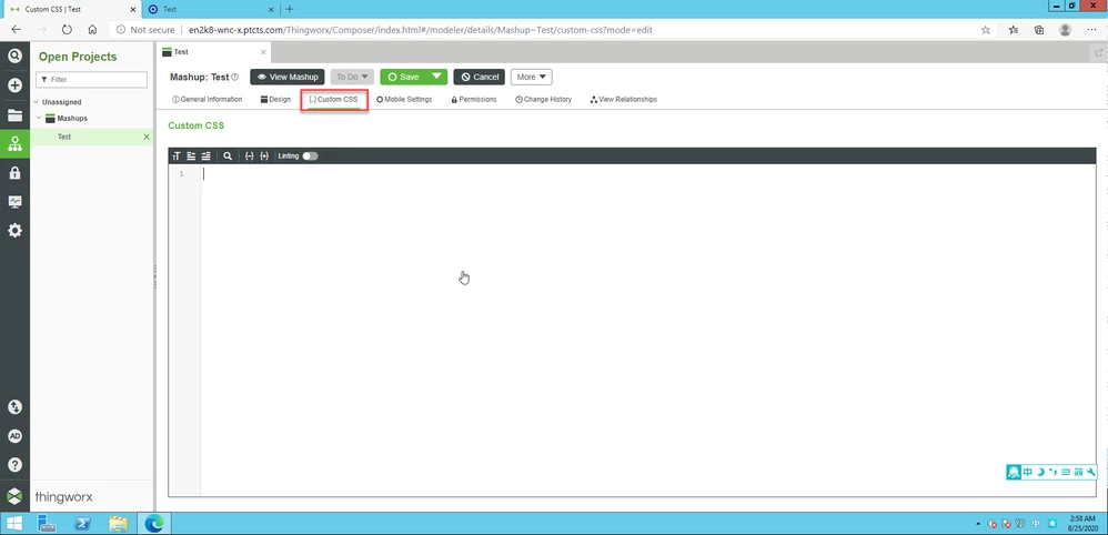

During my investigation, I found that this behavior is controlled by DIV CSS, maybe it can be solved by customizing DIV CSS.
You can investigate more deeply, refer to help center
http://support.ptc.com/help/thingworx_hc/thingworx_8_hc/en/index.html#page/ThingWorx/Help/Mashup_Builder/Mashups/MashupCustomCSS.html
I hope this information can help you.
