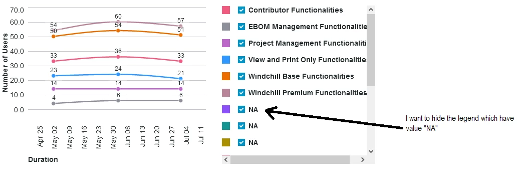

We have multiple datasources to it. There can be values in datafield for datasources. In service, if there is no data to show, we are setting datafield value to be NA. Because if we don't set datafield value then then chart doesn't get displayed.
Could you please tell if there is any way to hide the legend which have datafield value as "NA"

Hi
It hides all legend.
I want to hide those legends which have value as "NA". Please refer screenshot
Regards
Anirudha
