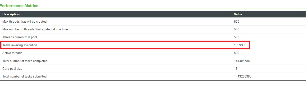

How to identify what entity that responsible for event processing reached its maximum?
I encountered an issue where the event processing queue has reached its maximum capacity of 200,000 tasks, leading to long execution times for subscriptions.
As my Thingworx server manages multiple projects, I am facing difficulties in identifying the specific entity responsible for this high volume of events. Is there a method available to precisely identify the name of this entity?
Your assistance in resolving this matter would be greatly appreciated.

Hi @Hamza_Zghoul.
Assuming you are running ThingWorx 9.x (though much of this will apply to earlier versions), you should review this documentation.  It would also be recommended to open a case so an engineer can help to analyze the artifacts that may be needed.  I will be happy to open the case on your behalf if you agree.
