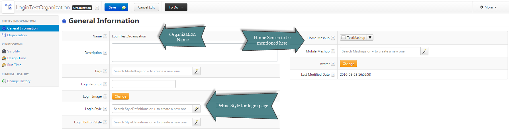

You can create an organization and while creating you can mention which mashup to be loaded as Home screen. ThingWorx will build a default login page for each organization.
An organization’s form page can be accessed with: <server name>/Thingworx/FormLogin/<Organization Name>.
For more details you can check ThingWorx Help Center.

Hi Ketan,
Yes it worked. Thanks.
