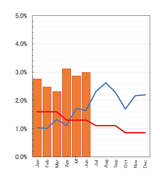

How to implement combo chart in ThingWorx 9.0.3 version
How can I implement a combo chart in ThingWorx 9.0.3, which includes a bar chart and a line chart?
We have had a combo chart since 9.3, however we are currently utilizing 9.0.3.

Unfortunately, I can only use version 9.0.3.
So here, the X axis is Jan to Dec.
1. The bar graph is current year for the months of January to June 2024.
2. Blue line represents prior year months, Jan 2023 to Dec 2023.
3. The red line represents January 2022 to December 2022.
Is it feasible to plot this type of requirement in 9.0.3 using a label chart?

Here, the X axis is Jan to Dec.
We have a combo chart in the newest version; can we import it into the 9.0.3 version?Could you please provide the widget for download?

Hello @Vinay_GL ,
Did you try to configure the settings suggested for the label chart widget in this community post for your ThingWorx 9.0?
Also, if it did not work for you, please let the community know so other community members can continue to help you.
