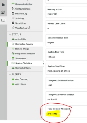

I have installed TWx 8.4.5 setup and can find the ThingWorx Allocated memory as 274.73 MB. Can anyone tell me how should I can increase it & how much I should put as Max here?
Please see the below image for reference.

You can increase it through Java options  (-Xms, -Xmx options) in Tomcat server.
Please see this article: https://www.ptc.com/en/support/article?n=CS227284
The max memory can be up to 75% of your server RAM memory.
If this is a production server then we recommend to give at least 10 GB memory to Tomcat, if it is a test environment then it is up to you the amount of memory.

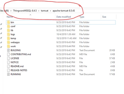

Thanks for your reply. I got your point, but actually as I installed a Package installer for version 8.4.5, I am unable to see the Tomcat dashboard for accessing memory pool options. Could you please tell me in which file of the Tomcat files I will get this setting so that I can edit it from there.
You may suggest the files with respect to following structure.
