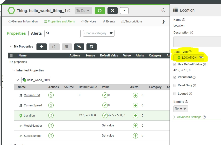

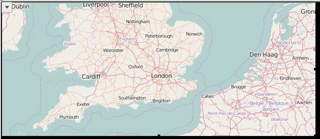

Hi everyone,
I started the work with maps e I am having difficult with it. I wanna do the following:
Create a marker on the map to show some expecific localization;
When click on the marker open other mashup or some pop up with the information that localization
The map that I am using are this:
(openStreetMap)
Best answer by Rick-Stanley
The Meet ThingWorx-visualize data step of the Meet Thingworx guide shows how to bind ThingWorx Things that have a property with a Location type to the Open Street Map widget:
June 12, 2019
