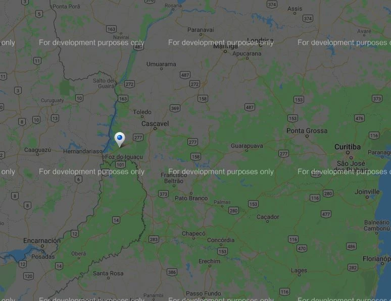

Hi everyone,
I have been working with google maps widget.
I am using this guide to orientation:
https://developer.thingworx.com/resources/guides/google-map-widget-how
I was able to insert just one marker on map, image below:
I'd like to insert more than one markers but i do not know how I do it
Can someone help me?
Leonardo
Best answer by leokeinsfeld
@SathishkumarC
I could to do it usind this kb:
https://www.ptc.com/en/support/article/CS221389?&language=en&posno=7&q=marker%20map&source=search
Thank you for all attention
Leonardo

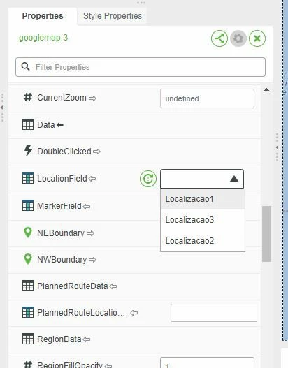

July 15, 2020
How many  rows of data you mapped with map widget?
If multiple rows of data available it will show multiple marker. Or you can use state formatting option in map widget properties to enable multiple icons based on any field.

Hi @SathishkumarC
I have three rows of data that I'd like to show in my map.
Image below:
But I don't know how can I to bind these three data in the property "LocationField"
