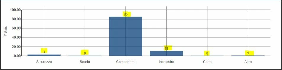

thingworx 8.5
I'd to know how do I put the value on the bar chart? Follow the example below:
I think that I might use CSS code because there is not the option in the Chart Properties

Hi @leokeinsfeld.
The feature for adding values to the top of bars or markers in Line and Bar Charts was added in ThingWorx 9.0.  It does not appear there are any plans to update the earlier supported releases.

Hello Leonardo,
This is not currently feasible in ThingWorx. However this request has already been raised to our R&D team as JIRA ticket <PSPT-2708> and they are working on it.

Hi @leokeinsfeld.
Just to clarify, we do have an internal ticket for adding this functionality.  However, it has not yet been approved for a future release.  I have reached out to the appropriate team for an update and will advise once the status is known.
