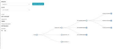

hii,
i want to integrate or show external ui on thingworx mashup. how do i do that? please suggest some solutions on this topic as soon as possible. below i am attaching the snapshot of the ui which i want to integrate or show on thingworx mashup.

This looks like a D3 tree, best way would be to either find the extension that exists out there somewhere, not sure where though, but I know someone made this a widget before.
Else create it as your own custom widget.

hi @PaiChung ,
i didn't find any d3 tree widget in marketplace....if you have some link to get this widget please share with me or if you have steps to create this d3 tree widget then please share with me asap

You would need to create this as an extension, that unfortunately is beyond my knowledge.
I do believe PTCU has some content around creating custom extensions (or used to)

@Ru_01 ,
Do you want to show this on a mashup from an external URL?  If so, you can use the webframe widget to do that.
