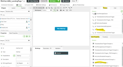

I didn't understand from where the session event to drag to either service or session parameters.

Clieck on any session variable... you will be seeing the events in data properties tab.
Drag the event to your custom service
