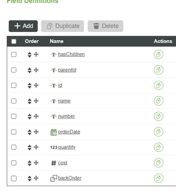

Use this arrow in DataShape FieldDefinition to set the order of fields. In the backend, it will set an ordinal number for fields
Here I moved hasChildren field to position 1
/VR

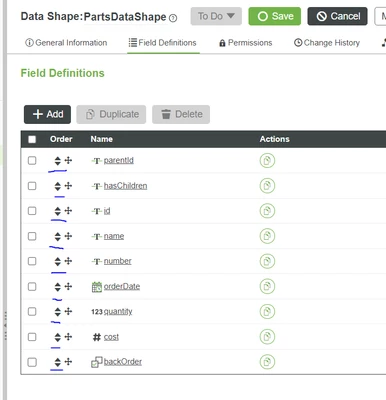

Sep 13, 2023 12:20 PM UTC
HI Velkumar,
Could you create service with infotable like Output. Please set you data shape for this infotable. Please create test mashup where you will try to call this service and check properties order for this output infotable.
I had Data Shape like this:
on Mashup side it looks like this:
the question is how can I keep the same order on mashup side?
Sep 13, 2023 12:45 PM UTC
Hi @JK_10565232
In Mashup DesignTime, field names will be sorted alphabetically. We don't have control over that.
It just makes mapping easier during design time it doesn't impact Mashup Runtime sorting.
