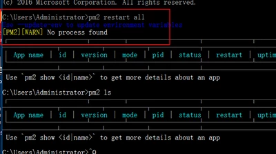

I installed thingworx flow successfully yesterday and ran command "pm2 ls" showed the complete components at the time .   However ,  today when I open the VM machine but found "pm2 ls" shows nothing.
What's I've tried:
1. run command "sc start RabbitMQ / rabbitmq.service" but it tells me the service is already running.
2. restart the workflow subsystem, but it doesn't help
3. I can access thingworx foundation with host and port which were specified when installing work flow, but I cannot open https://<host>:<port>/Thingworx/Composer/apps/flow/#/
If the workflow doesn't launch automatically,  how can I launch it manually ?

December 11, 2019
Try
pm2 restart all
seanccc17-PeridotAuthor
December 11, 2019
@rjanardan ,
The command just response:
[PM2][WARN] No process found .
