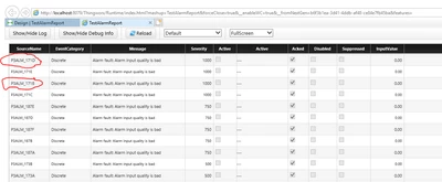

Hello Experts,
Good Evening...!
 I am looking for a method to link the Chart widget or another mashup to the values/parameters available in the Advance Grid containing info table data. Want your suggestions how I should get it done. FYI I am at beginner level about TWx platform

Hi @GSPatil.
We're not clear on what you are trying to do.  Where is the data coming from to populate the Advanced Grid?  If you're running a service, you could use the same service for your chart.
Please provide more detail around your use case and we'll try to assist if the above has not answered your question.

GSPatil1-VisitorAuthor
October 6, 2019
Hi Sheron,
Thanks for your reply. The data is coming to Advance Grid  via a Thing with MSSQLServer Templete having a Service that contains SQL query to populate some columns (output selected as info table).
I want to link a chart for every parameter in first column of the data (here its Alarm) or to a entire row , so that by clicking on any instance of the alarm in first column or entire row I can see its chart page with parameters like active time, frequency, state, etc
You can refer the table given at this demo example on Demo Link  ( use username as TWDemoB & password as BestPlatform ).  Here as there is separate page linked to each row & opens on single click. I want to do exactly same.

Hi Sheron,
Actually as mentioned earlier as I am new to ThingWorx Platfrom, I am unable to find the bindings or how its done in this demo. Hence you may say the issue is not resolved.
Also as I have installed the TWx foundation with MSSQL based 8.4.5 installer, I am unable to configure any widget in this by looking at tutorials. The only Grid is configured correctly & giving me data from SQL Database.
Is there any issue with a specific setting or issue with Persistence provider. Can PTC assist me with these types of  issue?
