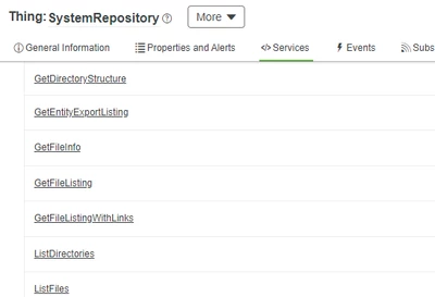

How to list the files in all the subfolders of a SystemRepository in a given directory.
Example path:
DCS001/R1/Device/Pressure/Pressure1.txt, Pressure2.txt, Pressure3.txt DCS001/R1/Device/Temperature/Temperature1.txt, Temperature2.txt, Temperature3.txt
We need a RestAPI/extension should have the following parameters:
Input file name: /SystemRepository/DCS001
Output: Pressure1.txt, Pressure2.txt, Pressure3.txt,Temperature1.txt, Temperature2.txt, Temperature3.txt
Kindly let us know the solution to achieve this usecase!
January 18, 2022
@AP_9587236
There are some OOTB services which you can use to list the files\directories in a repository, refer below screenshot,
