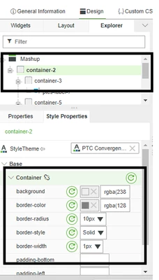

Hi @AP_10343008 ,
If you are using line border for collection cells means, please undo the collection cell border radius changes. And please try to do update only the style changes in Collection's Loader Mashup - Main Container . It may helps you.
Thanks & Regards,
Arun C
Aug 24, 2023 11:33 AM UTC
Hi @AP_10343008 ,
Have you tried with Collection Properties  >  Cell Border Radius - Value ? Based on that you can bring rounded corners to collection cells.
Thanks & Regards,
Arun C
Aug 24, 2023 12:43 PM UTC
It worked. But the border doesn't covered on rounded corners.
Arun_C16-PearlAnswer
Aug 24, 2023 1:50 PM UTC
Hi @AP_10343008 ,
Thanks & Regards,
Arun C
