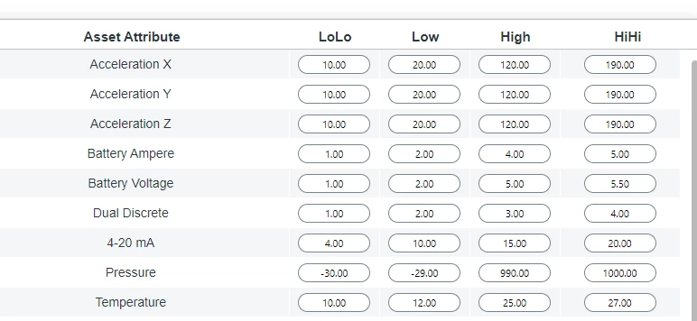

How to make grid cells editable without using edit icon or link ??
We need to have a grid with editable cells without clicking or hover options (ie) the grid cells should be editable at all the time. Attaching screenshot for reference.
Note: widget used is ptcs-grid

Hi @SV_10230677.
After testing, we found that the Advanced Grid appears to function as desired.  This is a legacy widget which will be removed at some point in the future, but you can continue to use it in the meantime.  I also recommend that you submit a request on the ThingWorx Ideas forum to request that the new Grid functionality be updated to match that of the Grid Advanced.
