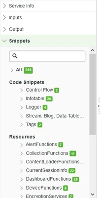

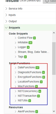

If login using Administrator, I can see lots functions under "Script Functions",  but if I login using another user who has full permission on all of entities,  I cannot see any script functions in the code snippets although the function still work if call it .
===============Login with Administrator============
===============Login with another user============

Hello @seanccc,
Script Functions are only visible and accessible by users in the Administrators User Group. Please add the desired user to this group in order to make Script Functions visible to them.
Emmanuel
