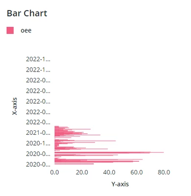

How to make the bar chart to be displayed for 7 days as a limit instead of getting all data?
I am using thing Worx 9.3.0 version , I want to display the 7 days data on the bar chart , whether it may be recent 7 days or any when I select the start date to end date only that data should get displayed in the mashup ,
As of now my mashup bar chart is having data from last 2 years so I need to make the chart which can be selected and viewed according to dates instead of all data
please help me what needs to be done  , if anyone have some ideas on this

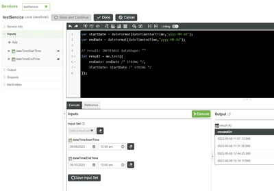

Hi @NH_shree
You can create a service with dateTime inputs to accept input from DateTime Widget and query data from DB
And whenever DateTime value is changed in Mashup, you can trigger this service to fetch new Data from DB
/VR

NH_shree14-AlexandriteAuthor
May 15, 2023 5:15 AM UTC
Here is the bar chart image that i am getting , we cannot make out anything from this and it is looking like a thin line instead of bar , please help if anyone has a solution with you.
