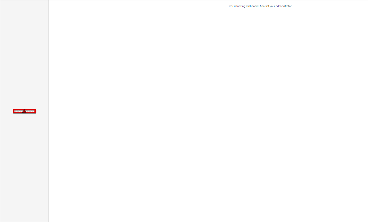

This means that mashups for projectA and projectB are identical so, I want to know: instead of duplicate them, is it possible to create the same but allow to userA only to see data of projectA and same for UserB?
Plus, there will be some helper things for the template or master (which will be the same for A and B), is it possible for this things to have different values when is either logged UserAs or UserBs?
I tried creating Users and GroupUsers; then I created OrganizationA and OrganizationB.
In my thingA, under tab Visibility I added OrganizationA; then I created a simple mashup with just a list and a dashboard.
In the list there is the "QueryImplementingThings" service of the thingtemplate (which holds both thingA and B).
I expect to see ThingA in the list when I log with UserA and ThingB when I log with user B, instead I only see this:
October 3, 2016
You should have something wrongly defined under Visibility or Permissions, but you should do as you described through visibility, setting visibility on Things and Users through different organizations, or in the same organizations but on different nodes of the hierarchy.

Ok: this is what:
ThingA:
Visibility: OrganizationA
Design Time: GroupA allowed to read, update and delete
Runtime: GroupA allowed to Property Read, Property Write, Event Execute, Event Subscribe, Service execute
Mashup:
ProjectA:
Design Time: Group A allowed to all
Runtime: Group A allowed to all.
If I go on mashup I can't see anything (like the image I posted above).
If I go on ThingTemplate:
DesignTime: GroupA allowed to all
Runtime: GroupA allowed to all
In mashup I see both thingsA and thingsB

Hi Fabio,
From your description it's hard to say, you din't said nothing about Visibility on ThingsB, you may have "Everyone" group/visibility on collection level that may effect this...

UserB is symmetrical to UserA
ThingB:
Visibility: OrganizationB
Design Time: GroupB allowed to read, update and delete
Runtime: GroupB allowed to Property Read, Property Write, Event Execute, Event Subscribe, Service execute
Mashup:
Visibility: OrganizationB (and with OrganizationA)
ProjectB:
Design Time: Group B allowed to all
Runtime: Group B allowed to all.
In other words, I want everything ends with B is seen by UserBs and not by As and viceversa
fmanniti1-VisitorAuthor
October 3, 2016
Ok. It seems everything works now.
I deleted the two users and created them again.
Just to say, I followed this
http://support.ptc.com/cs/help/thingworx_hc/thingworx_7.0_hc/index.jspx?id=DashboardConfiguration&action=show
(It may be usefull in the future)
if I will have any more problems in the future, I will update this post.
Thank you
