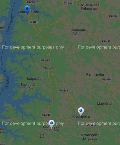

Hi everyone,
I have created some markers on google map and I'd like to navigate to another mashup when I click on marker.
I was looking for solution on knowledbase and I was able to find some artycle that said to use navigate widget.
I am using thingworx 8.5 and there is not this widget in this version.
Is possible do it?
Leonardo
Best answer by slangley
Hi @leokeinsfeld.
Navigation has moved to the lower right corner of the mashup builder under Functions.  Here is a link to the help desk.
Regards.
--Sharon
Support
July 15, 2020
Hi @leokeinsfeld.
Regards.
--Sharon
July 20, 2020
Hi @slangley
I was able to do it using the navigation function.
I did not know it had changed.
Thank you
