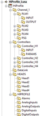

I'm trying to build a service to call the BrowseGroups service from the root of a channel and then recursively call it on all of its subgroups (if they're not a System group) until they've all been visited and then return them in an InfoTable.
So, for example, I'd call the service on "HiProfile_LBR" and it would then call itself on "HiProfile_LBR.HiProfile" and so on...
(I collapsed the groups, but the channel in the example has more levels than what's shown in the image.)

The service unfortunately times out for complex trees (such as the one in the image above) and I have no idea on how to solve this issue. Besides increasing the service time out (to a value at the moment I don't know), how can I solve the issue? How would you optimize my code?

aiGreek1-VisitorAuthor
Mar 15, 2021 8:45 AM UTC
Hi @slangley,
I can't check the log files as the platform is hosted on the PTC Cloud. I did check the ScriptLog from the Monitoring interface and I can confirm it's timing out, as I get this message: Execution of Script terminated after : 42 seconds. Timeout configured for 30 seconds.
The data I'm trying to process at the moment is this channel/device tree on a Kepware (note that PLM2/3/4 and Controller_H2/3/4 have the same underlying structure as PLM1/Controller_H1):
