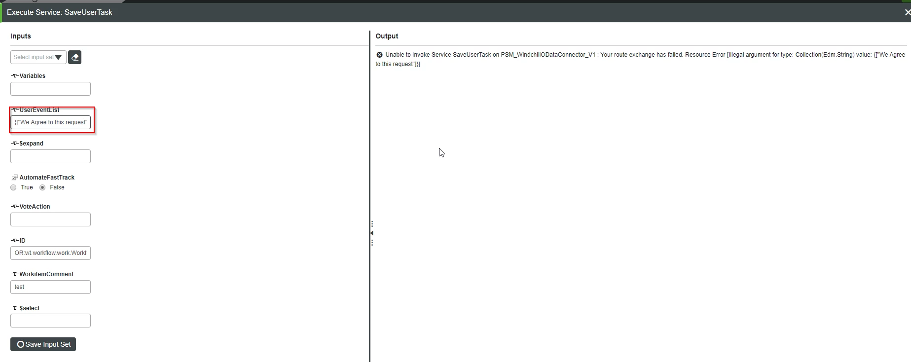

How to pass Collection(Edm.String) parameters to oData SaveUserTask POST API from ThingWorx?
We are trying to call a post method oData API with different set of params. I have attached a picture which has parameters and error thrown by API. Please assist, how to pass collection(edm.string) to oData API.

Unfortunately, there is no reference of  SaveUserTask service in ThingWorx documentation, but I recommend to try to set parameter only to : "we agree to this request"
Hope it helps,
Raluca Edu

Sorry, my mistake. SaveWorkItem is the reference in (Windchill REST Services)WRS 1.5 documentation at page no 152.
Please check and assist. thanks!
SaveWorkitem
The SaveWorkitem action saves the specified task. The action is bound to the
Workitem entity.
You must provide the following mandatory parameters as input to the action in the
request body:
"UserEventList":[<routing_options >],
"WorkitemComment":"<comment_for_the_workitem>",
"VoteAction":"<Vote_option_selected_by_the_participant>",
"AutomateFastTrack":<option_to_specify_if_change_notice_should_be_
explicitly_created, valid values true or false>,
"Variables":[<workflow_activity_variables>]

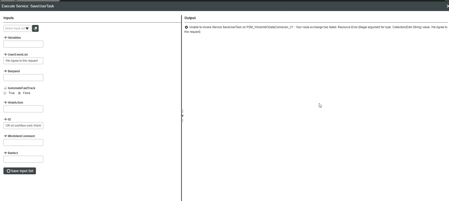

Even if we pass We Agree to the Request still issus exists. please refer the attachment
