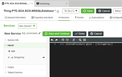

Above logic should be written in javascript service? If yes, How can i call below exec SP here?
exec [StoredProcedure] @json = [[StringArray]]

Hello @Vipul_Oswal,
Let me clarify it a little bit:
Regular thing: Javascript Service:
let jsonString = InfoTable.toJSON();
let stringArray = jsonString.rows;
Things["YourDatabaseThing"].UpdateDataBaseWithJSON({
 StringArray: stringArray
SQL thing: SQL Command Service:
Example Stored Procedure:
ALTER procedure [dbo].[_InsertPersonData]
	@json NVARCHAR(max)
as
begin
 MERGE INTO [User] AS target
 USING (
 SELECT
 distinct PersonnelNumber, FirstName, LastName, PlantUID
 FROM OPENJSON(@json, '$.rows')
 WITH (
 OrgID NVARCHAR(256) '$.OrgID',
 PersonnelNumber NVARCHAR(256) '$.PersonnelNumber',
 FirstName NVARCHAR(256) '$.FirstName',
 UserRole NVARCHAR(256) '$.UserRole',
 IsHybridArea bit '$.IsHybridArea',
 UserOrgType NVARCHAR(256) '$.UserOrgType',
 OrgName NVARCHAR(256) '$.OrgName',
 LastName NVARCHAR(256) '$.LastName',
 PlantUID NVARCHAR(256) '$.PlantUID',
 CostCenterID NVARCHAR(256) '$.CostCenterID'
 ) AS source
 ON target.personid = source.PersonnelNumber
 WHEN MATCHED THEN
 UPDATE SET
 plantuid = source.PlantUID,
			firstname = source.FirstName,
			lastname = source.LastName,
			isactive = '1',
			updatedby = 'System User',
			updateddate = getdate(),
			shiftuid = '1',
 WHEN NOT MATCHED THEN
 INSERT (plantuid,personid,firstname,lastname,roleuid,isactive,shiftuid,createdby,createddate)
 VALUES (source.PlantUID, source.PersonnelNumber, source.FirstName, source.LastName,'7','1','1','System User',getdate())
 WHEN NOT MATCHED BY SOURCE THEN
 UPDATE SET target.isactive = 0;
end
Your stored procedure might look different as you are using MySQL.
