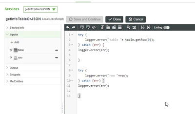

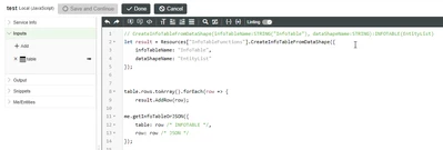

Thing rowParamter
two services:
1. getInfoTableOrJSON with two inputs (INFOTABLE and JSON) that will print the value of the name
2. test get an info table as input and send each row as an info table and row to getInfoTableOrJSON.

Thing rowParamter
two services:
To test:
execute the test service and provide a row (use the Add+)
See the script log prints (it is an error just for visibility)

Hi ashaban,
Thanks, the first approach worked, (create a temporary info table with a single row (the row you would like to pass) and The called service will define an info table input parameter and access the first row).
