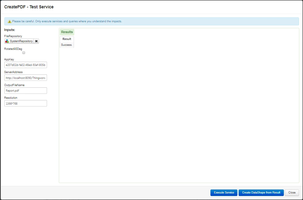

Hi all,
   I am using PDFExtension to create pdf for my mashup.
When I pass the server address and executing the CreatePDF service I am getting empty pdf.
Please help me to resolve it.
Please find the attached screenshots.

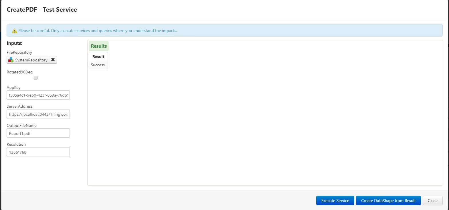

I saw the attached screenshot ,the problem is you did not pass the App Key in the arguments .Pass the app key of the associated user from which you are logged in .For example if you are logged in from Administrator ,there will be a app key in the Security -> App Key section of the composer .See the tested screenshot from my instance .
Let me know if you are not able to get the PDF even after passing the App Key .
Thanks ,
Mukul Narang

Hi Mnarang,
   I am passing the APP key too and still I am getting empty pdf. Below are the values I am passing as parameters.
FileRepository : SystemRepository
AppKey : e207d02d-fa02-48ed-93af-805be887c290
ServerAddress : http://localhost:8090/Thingworx/Runtime/index.html#mashup=testmashup
OutputFileName :  Report.pdf
Resolution : 1366*768
Please review and let me know how to proceed.
Vamsi

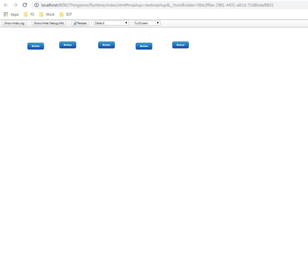

Ideally it should work ,this is how we execute this service .The app key which you are using is associated with which user ? Can you directly hit the server address in the browser tab when you are logged in from the user which is associated with the app key ? I can see that you have 4 buttons on the test mashup ,do you see these after directly hitting the server address in the browser tab from the user who is associated with the app key ?
Reason being ,this is how it works .It tries to take a snapshot of the server address from the user who's app key is there in the argument .
