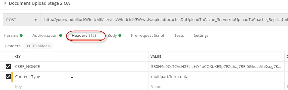

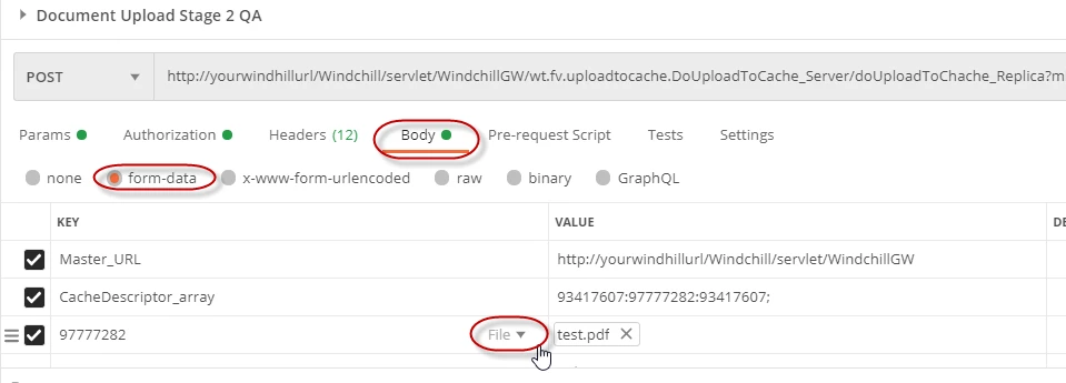

I am attaching sample screenshots of Postman Call for Upload Stage 2 Action:

Hello @Constantine ,
Issue is this only, how to pass file in PostMultipart call.
I tried passing the file repository and path to file, it didn't worked.
I also tried passing file as Blob data in the parameter "partsToSend", but that also didn't worked.
Below is sample code that I tried in Thingworx:
// Set up the request headers
var headers = {
 "CSRF_NONCE": csrfToken,
 "Content-Type": "multipart/form-data; boundary=-----------------------------boundary"
const table = Resources["InfoTableFunctions"].CreateInfoTable();
table.AddField({
	baseType: "STRING"
table.AddField({
	baseType: "STRING"
table.AddRow({
	Master_URL: masterURL,
	CacheDescriptor_array: cacheDescriptor
let params = {
	proxyScheme: undefined /* STRING {"defaultValue":"http"} */ ,
	headers: headers /* JSON */ ,
	ignoreSSLErrors: undefined /* BOOLEAN */ ,
	useNTLM: undefined /* BOOLEAN {"defaultValue":false} */ ,
	partsToSend: table /* INFOTABLE */ ,
	workstation: undefined /* STRING {"defaultValue":""} */ ,
	useProxy: undefined /* BOOLEAN {"defaultValue":false} */ ,
	repository: "FileRepository" /* STRING */ ,
	proxyHost: undefined /* STRING {"defaultValue":""} */ ,
	url: url /* STRING */ ,
	timeout: undefined /* NUMBER {"defaultValue":60} */ ,
	proxyPort: undefined /* INTEGER {"defaultValue":8080} */ ,
	password: "Password" /* STRING */ ,
	pathOnRepository: "/Report.html" /* STRING */ ,
	domain: undefined /* STRING {"defaultValue":""} */ ,
	username: "User" /* STRING */
// result: JSON
var result = Resources["ContentLoaderFunctions"].PostMultipart(params);
