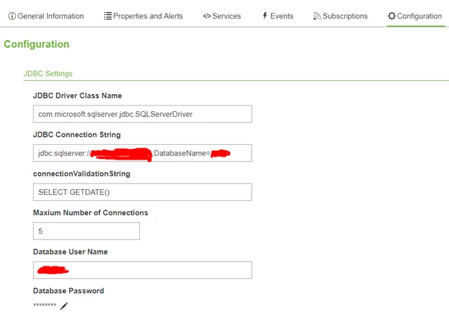

HI @UY_9515947
Usually, we ping it from the server that hosts ThingWorx. Can't you access the server?
September 20, 2022
I can access both ThingWorx hosting and Database server.
Let me explain the case :
we are creating multiple MSSQL Things with JDBC Settings Parmeters as inputs.
so, wanted to Validate JDBC Settings Parmeters before creating the Things by pinging the database.

HI @UY_9515947,
Create a Thing with DataBase ThingTemplate, go to the Configuration Tab, and do the following configuration for MSSQL.
