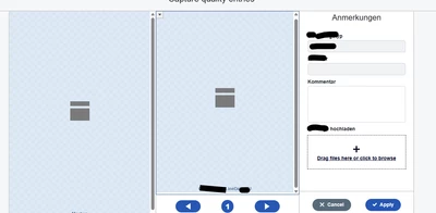

How to Preserve Textfield Values When Navigating Between Contained Mashups
  i have this center one below a contained mashup which i am switching among 3 mashups so each mashup has textfields to fill. my question is when i write something in textfield then  i click next and get another mashup and now if i go back to previous mashup then the values which i filled in it would be gone obviously its removing the mashup and loading new one.
i am thinking to achieve this task now to have four containers with each mashup in it and do visible invisible on them and then the values would stay or have four contained mashups in four containers and do invisible visible on them.... i am asking this query to know more about the resolution of this usecase.. any suggestions are welcome..
