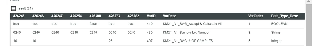

Currently, I am not applying any sort in service, You can see in screenshot, Whatever , I am sending as an input sequence, same I want in infotable service output. without sort ascending order

Can you provide some code snippets from your service to help us understand how you are building the infotable.  My assumption from your screen shot and using "Dynamic Columns"  is that you are creating the data shape for the info table on the fly either entirely or adding columns to an existing data shape using AddField or fieldDefinitions.
In either case column order is not guaranteed to be in add order by default.  If you want to guarantee columns are in a specific order you must specify the ordinal property when adding the column.  Please see the following support cases for examples: CS313173 CS388066

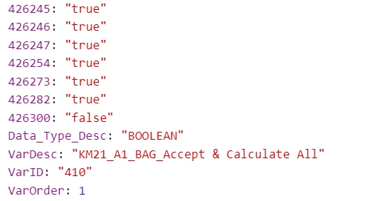

Now, Service giving desired output when executing service manually from composer but when checked in runtime 'Developer Tools' not getting desired output
Pls check both screenshot
Let me know any solution on it
Jul 7, 2023 10:09 PM UTC
A json object does not account property order. (https://stackoverflow.com/a/16870531)
The "ordinal" property is a twx-specific metadata which twx toolings will consider. The "wanted" order you can see in developer tools response in "datashape" (your screenshot shows the "rows" of the response)
May I ask the use case why you rely on the order of the properties?
