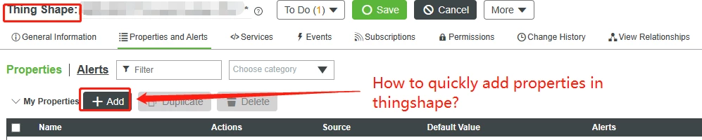

How to quickly add properties in thingshape?

Snoopy_hu11-GarnetAuthor
11-Garnet
Apr 12, 2024 5:44 AM UTC
Hi @Velkumar
Thanks! I would like to add multiple attributes through a service, I tried the help you provided and found it, but unfortunately why doesn't thingshape have this service?
Rocko
Apr 12, 2024 7:00 AM UTC
ThingShape is not in the same inheritance line as ThingTemplate and therefore the services are not visible to the end user.
