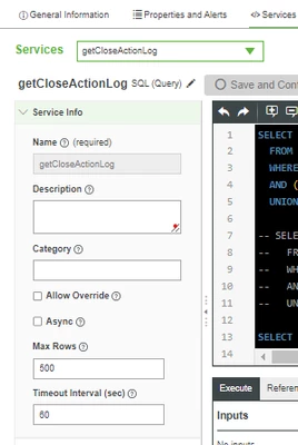

Do you guys know that how can i make infotable to show more then 500 rows. I am getting data from SQL query and its more then 500 but as the infotable only shows 500 rows. any idea how can i fetch more then 500? For datatable i know how to make it work with maxItems but i am not sure about infotable.

Apr 18, 2024 8:50 AM UTC
Hi @MA8731174 ,
Kindly increase the Max rows from Database Thing - SQL query service. If you need to all rows make it with -1. It will works.
Kindly find the attached link - https://www.ptc.com/en/support/article/CS332284
Thanks & Regards,
