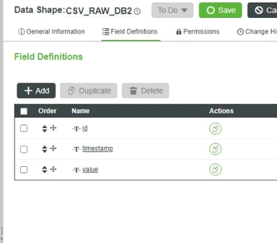

how to read csv file and then input in datashap

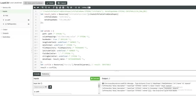

this is my service and my datashap
this csv file

The comment in line 18 indicates you should provide the name of a datashape.
You are providing an infotable.
Instead of result_table, try to pass just the string "CSV_RAW_DB2".
Also, consider switching to a supported CSV Reader.
