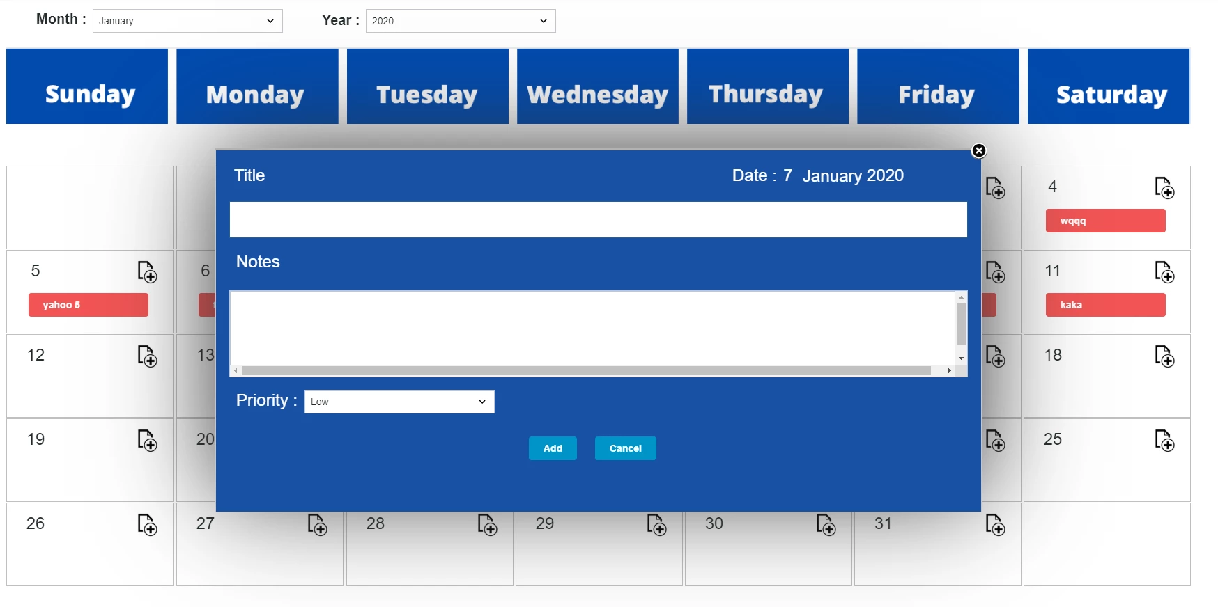

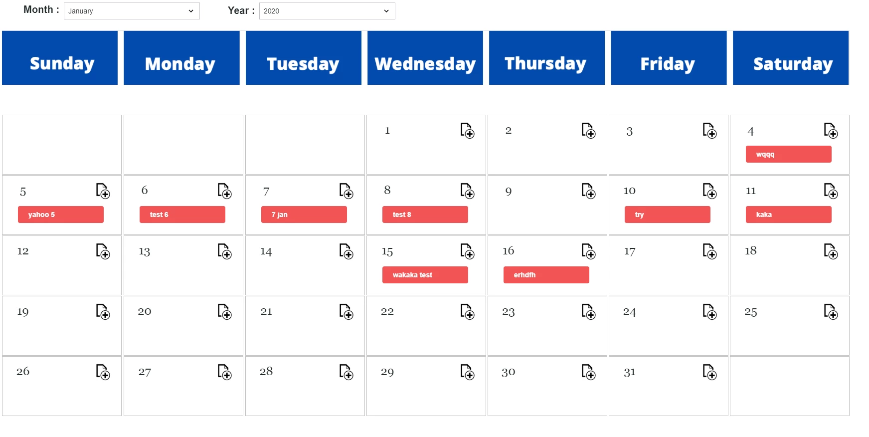

I have a main mashup that contains a collection widget with some cells. Each of this cell has a button that navigates me to a popup window if clicked (using navigation function). In this case, if the user click an 'Add' button in the popup window, this will add something in the corresponding cell of the collection widget. My problem is once I click the "Add" button the cell is not updating in the main mashup unless i click on reload button on top. So I was thinking is there any way that I can refresh the main mashup on the event of the popup window close?
