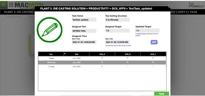

On clicking "Apply" button in this popup, i want to reload the main mashup. On clicking a button, one service will be called. I binded that service serviceInvokeCompleted to an expression which having a code "location.reload();". But the page is not refreshing. How to do this.

I have given location.reload(); inside popup. It reloaded the parent mashup also only when "Apply" button clicked for double times. But i want it to happen on single click itself.
