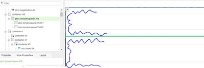

Does anyone know how to remove this extra space in dynamic panel ?

Hi @Velkumar,
Depending on your ThingWorx Platform version, the following CSS might not work, but have a try adding below code to your Mashup's CustomCSS
ptcs-dynamic-panel::part(panel-wrapper) {
    position: unset;

It worked on 9.0!
