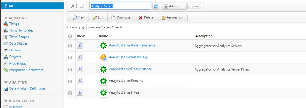

Aug 19, 2018 12:56 AM UTC
hi
i try to search AnalyticsServer_DataThing in the composer.but i can't find it.
is it there is no that thing in the version 8.2?
Kind regards
Minnan
Aug 20, 2018 4:55 AM UTC
Hi @MinNan
Could you try to find *DataThing
May be the suffix of this Thing is different. But it should end with DataThing.
Mohit
