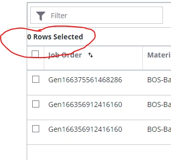

I have used Grid widget with multi row selection on grid.
After doing so if we select multiple rows it does show how many rows we have selected on a grid as a selected rows label.
I wanted to hide it or turn it off but not getting any property to do so.
looking for any suggestion using which i can turn it off.

Thanks for the suggestion marc seems like css is the only solution on this in that case i will have to go with other approach but thanks to everyone for giving solutions.

Hi @danmorin
Before posting this issue i referred this post and now also i tried it but it doesn't get rid of that label.
so issue is still persisting.
