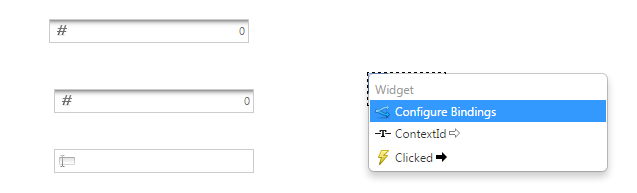

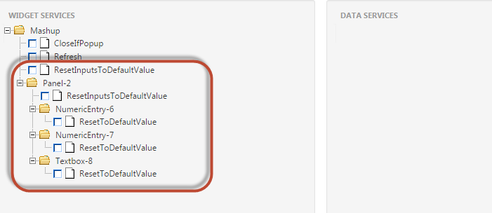

Dada, here's some screenshot to help you get going
  1. Configure Bindings for the Button which should trigger the event so the ResetInputsToDefaultValues service could kick in

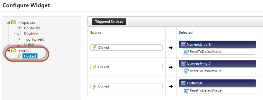

2. On the Configure Widget window Select the Clicked Event and then Click on the Triggered Services and there you can see the possibility to reset the values for complete Mashup or you can individually select the TextBox or the NumbericBox which needs to be resetted once the button is clicked
Once this is done click on Done > Save the Mashup and this should be it. Now when the button is pressed the values will be reset to default value if you have it set for that particular box widget.
