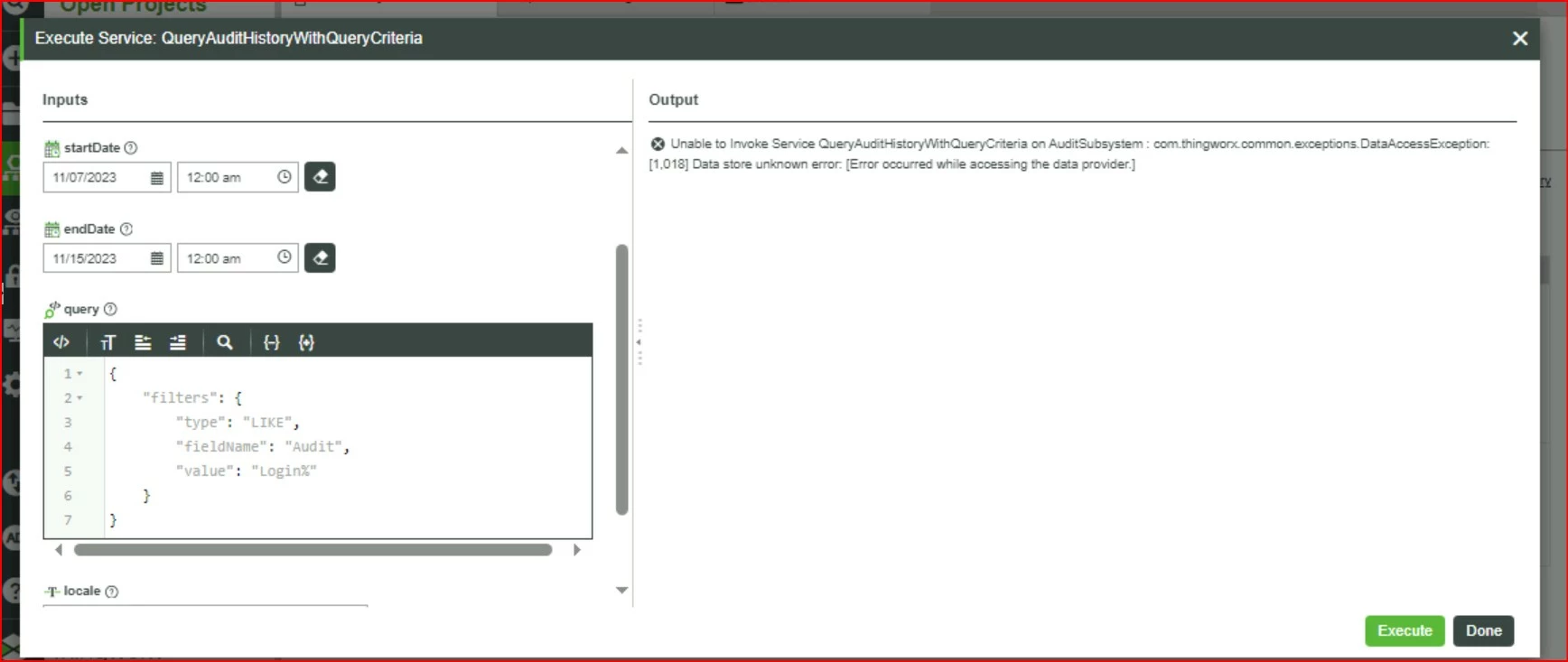

Hi Community,
I need to access following information from ThingWorx Number of users logged in and their time.
For this I am trying following service: "QueryAuditHistoryWithQueryCriteria" following ptc article:
https://support.ptc.com/help/thingworx_hc/thingworx_8_hc/en/index.html#page/ThingWorx/Help/Composer/System/Subsystems/AuditSubsystemSearchAuditData.html#
Could you all please help me provide correct json input as filter I should provide for same.
Attaching screenshot for same.
json query:
"filters": {
"type": "LIKE",
"fieldName": "Audit",
"value": "Login%"
Error:  Unable to Invoke Service QueryAuditHistoryWithQueryCriteria on AuditSubsystem : com.thingworx.common.exceptions.DataAccessException: [1,018] Data store unknown error: [Error occurred while accessing the data provider.]

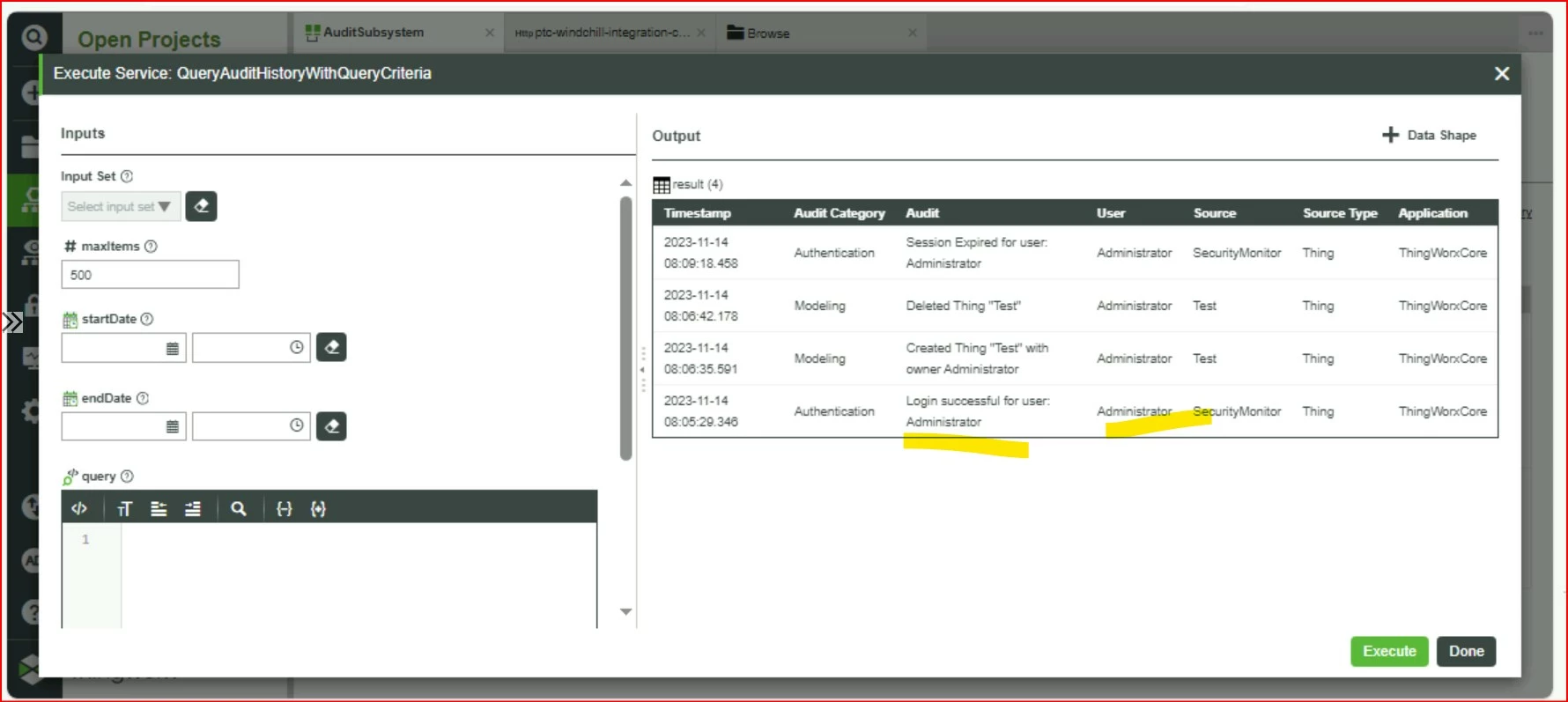

Hi @Velkumar ,
 Thanks it worked. Could you please tell why we are specifying message in fieldName when we don't have this in header received?
Sid
Velkumar19-TanzaniteAnswer
Nov 14, 2023 9:13 AM UTC

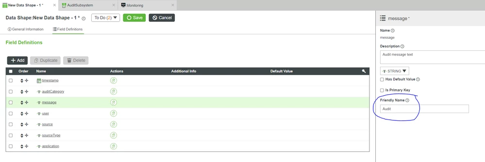

Hi @Siddharth_Jhs
FieldName displayed in the result is a DataShape Friendly name. You can find the actual fieldName by creating DataShape from the result
/VR
