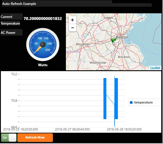

MyHome example in Get Started with ThingWorx for IoT includes a temperature parameter, streamed from server (value changes periodically).
I want to display that in my Mash as a number, in a text box widget but can't figure out how to round up the numbers.
Can anyone help please?
I don't know which widget did you use to use the temperature, but if you did use a ValueDisplay you have to go to ValueFormat parameter on widget and set Renderer: Number and on format 0.00 for instance to round to two decimals.
pobi1-VisitorAuthor
I've attached my current Mashup.
pobi1-VisitorAuthor
That works. Thank you CarlesColl!
