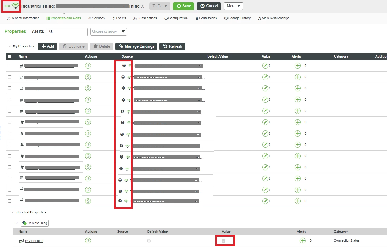

In my application, I have 100+ Industrial Things remotely binding properties from Kepware.
Every time when I restart Thingworx service, I found all the tags/properties have "Unknown" quality for all 100+ Industrial things in Thingworx.
I need to manually navigate to each thing and need to save the Thing. when I save the Thing, property/tag quality becomes "Good" in that particular Thing in Thingworx.
