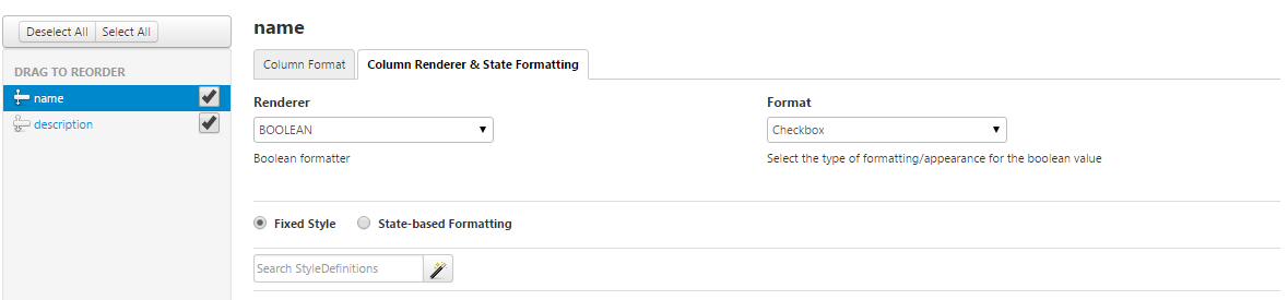

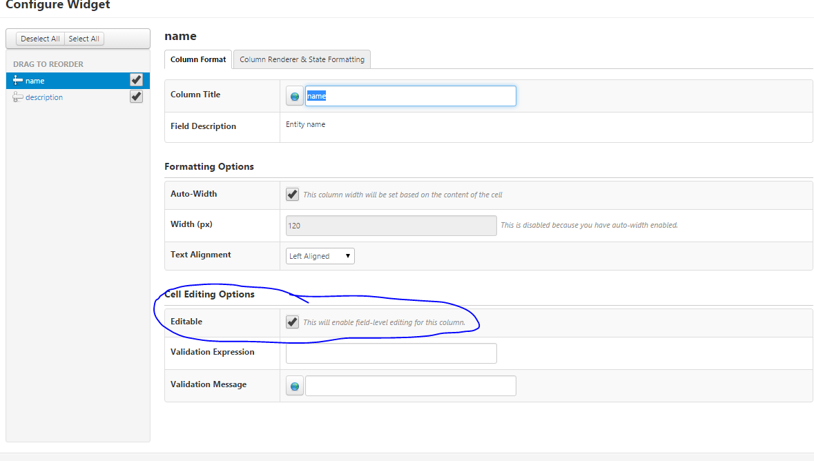

    When you bind your data to the grid, make sure the property/column is a boolean.
    You can then edit the grid columns. Choose the column, check the Editable checkbox, as well as to make sure the Render is set to Boolean and that Format is Checkbox
    Then, to bind out the new edited data, you will need to wire the EditedTable to a service that will parse the data.

    Another question, is there a way to change grid's editable option on runtime?
    Dec 24, 2015 4:46 PM UTC
    There is not a way to change grid's editable option on runtime. You'd have to modify the grid widget.
