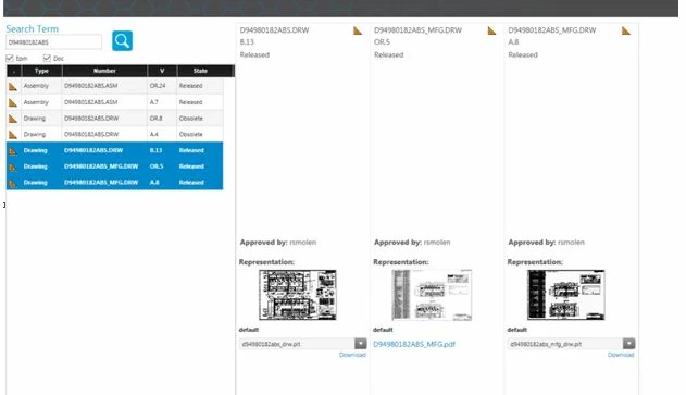

I have one more Issue now, I want to select multiple row and display each Image related to that row.
I have attached the sample to this reply , which shows how my output should be like.
January 3, 2019
Just allow multi-select on the Grid, and bind Selected Rows to a service that returns the Infotable with the images an other information.
For the right panel (the one with images and other widgets) use a Repeater widget with the output of the previous service.
