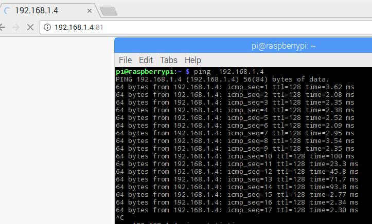

From Raspberry pi, I can ping tomcat hosted on my laptop.

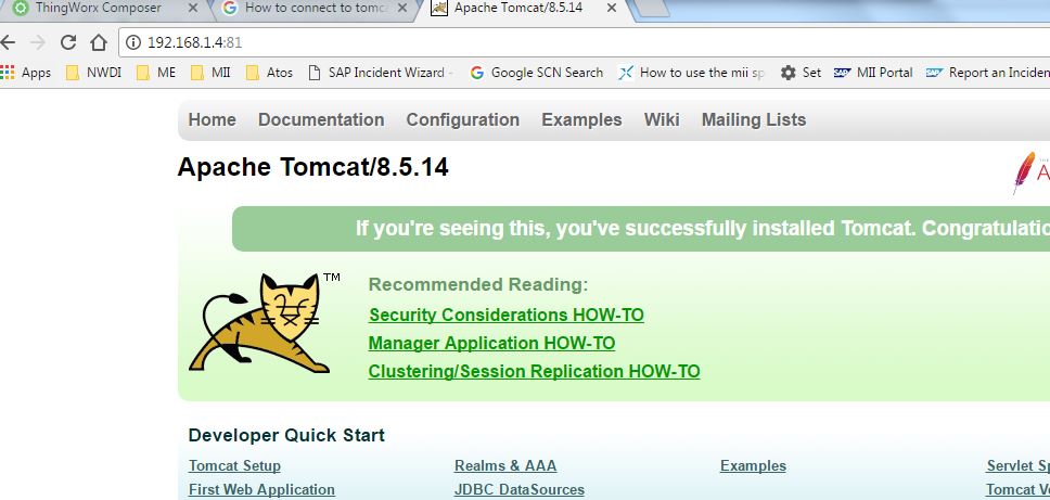

http call from pi to tomcat tries for ever.
Tomcat call from laptop.
Could it port issue from raspberry pi? How to open 81 port from rasp?
